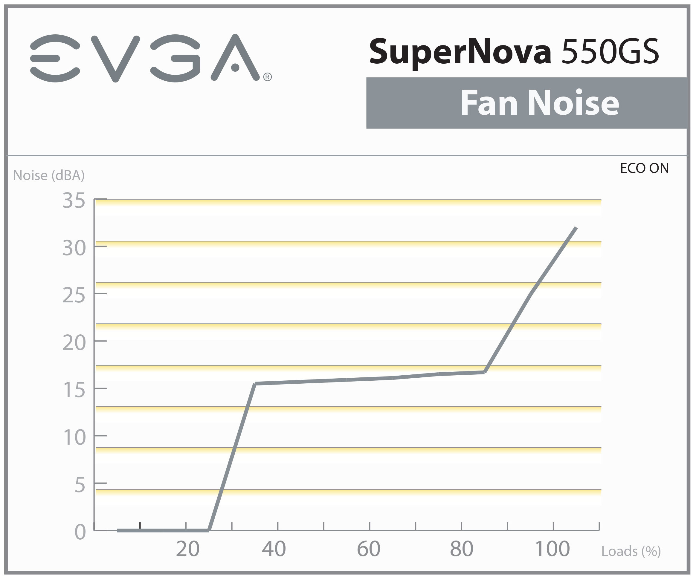

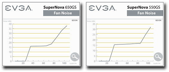

Introducing the EVGA SuperNOVA 650 GS and 550 GS power supplies. These power supplies take the award-winning features of the new EVGA "GS" lineup and provide them at an extremely affordable price. The EVGA SuperNOVA 650 and 550 GS power supplies offer superior performance, Gold-rated efficiency and are completely silent when under low loads*. Backed by a 5 year warranty and high quality Japanese capacitors, these power supplies are the right choice for excellent efficiency, low noise levels and incredible value.
*With ECO mode

Highest Quality Japanese Nippon Chemi-Con Solid State Capacitors
Get the most reliability and greatest performance with the use of the highest possible quality Japanese solid state capacitors.
Teflon Nano-Steel Bearing
High quality Teflon Nano-Steel bearing ensures long life and nearly silent operation.
Gold Rated Efficiency
80 Plus certification ensures your power supply isn’t wasting power and turning it into excess heat. Under typical load this power supply is 92% efficient or higher.
